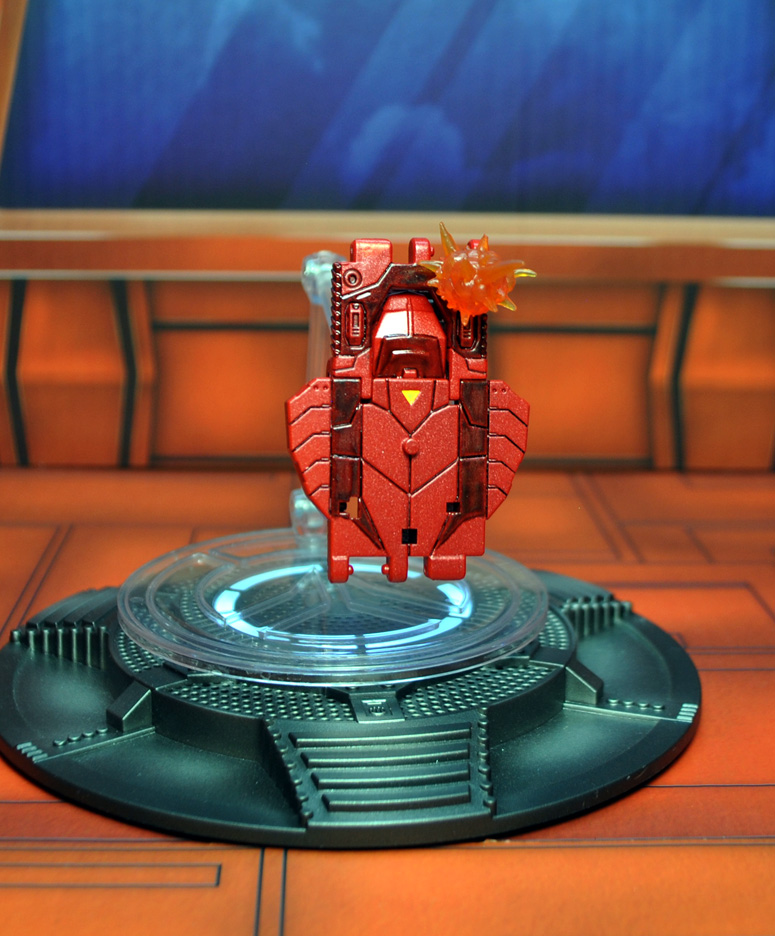

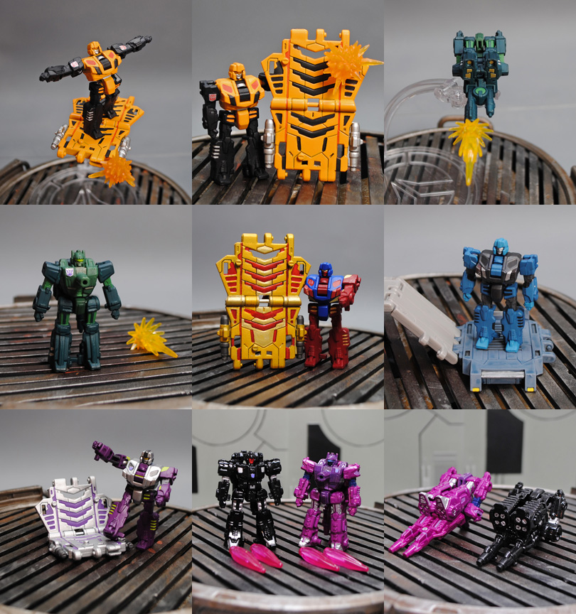

Some kinds of plastics are extremely resistant to paint no matter what you do. These are usually toughened waxy plastics/superhard plastics like polyoxymethylene that make up parts of a figure that could easily be stressed if made from the usual pvc or abs. The limbs of the Transformers Siege Battle Masters are made of this stuff and you need to color them, so what do you do? It's RIT DyeMore for synthetics to the rescue! Mix half the bottle of dye with a cup or so of water, boil the liquid on med to high heat just so you get a gentle rolling boil and drop your parts in. I like to suspend mine in a strainer so I can 'lift and look' to check the color. In under a minute the pieces will start to be dyed with a color that won't rub off! The longer you soak them the deeper the color. I tried this using Siege Aimless and Earthwise Soundbarrier with excellent results.
I modded Soundbarrier so you can remove his ramp from his back and pop it back on. The RIT DyeMore works best on light colored plastic and will easily change one color to another such as Aimless' light blue body to a deep red. I've created different color-match Battle Masters now that you can pair up with Transformers like Hound, Grapple, the Predacons, and more! Also I created Spinister's Targematers Fracas and Shrute using the DyeMore Pink, violet and Graphite dyes. They were then primered with Bulldog Adhesion promoter, painted using Testors Fantasy Armor set lacquers (metalizers), and sealed with Mr Hobby premium spray sealer. Seeing as how these two are impossible to find outside of the $200+ set, why not make your own?
For more pics head to their pages here: Dyeformers Fracas and Shrute

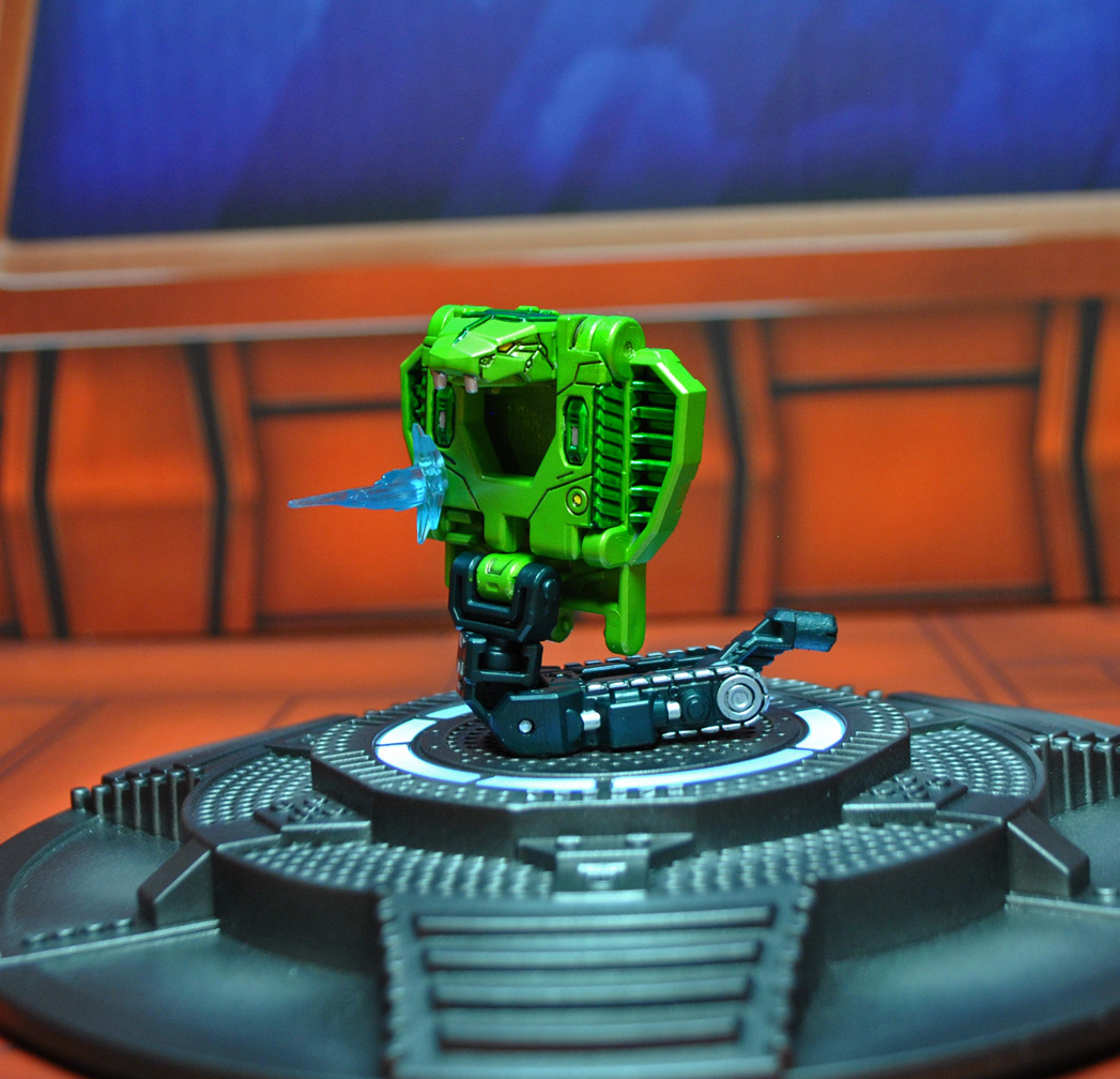

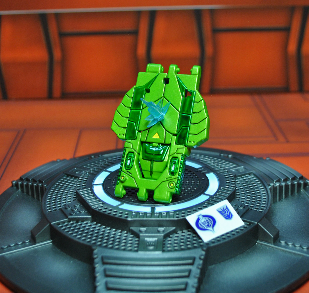

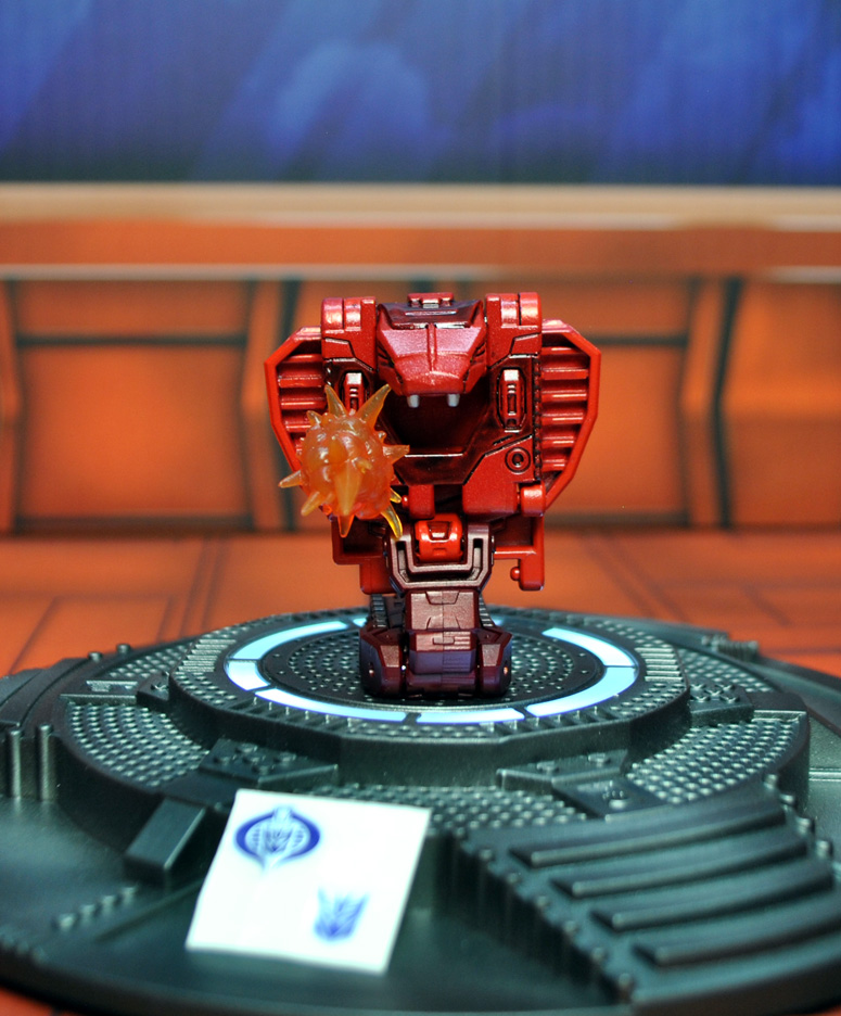

More Dyeformers are here! Here's Slitherfang done up in red/green colors using Rit DyeMore for his lower tank body and Tamiya/Testors lacquers for the upper clear parts.
