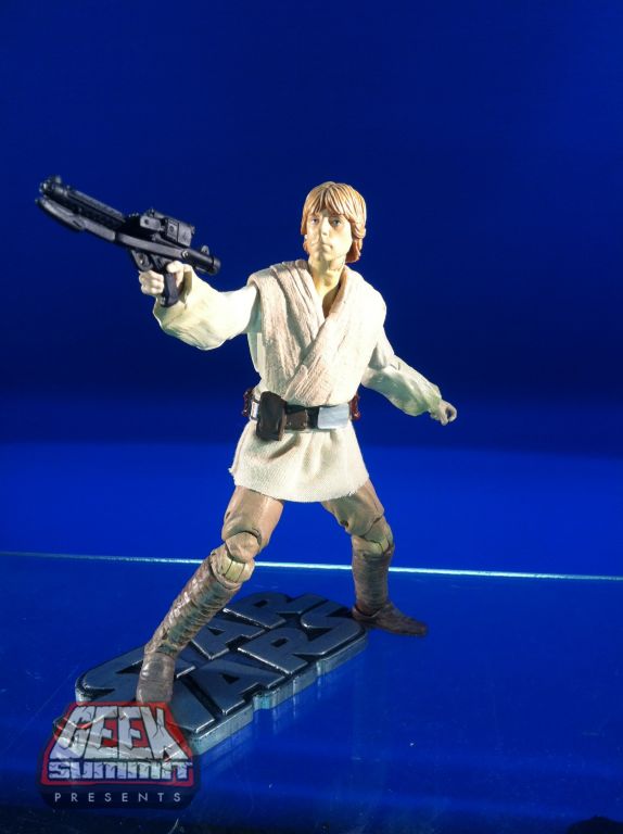

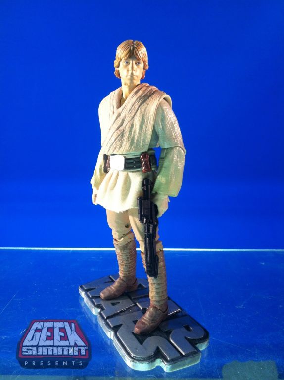

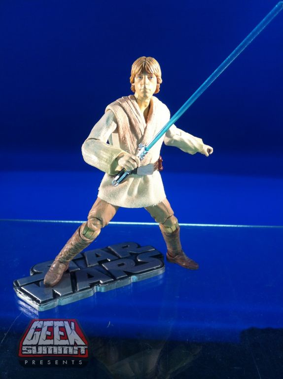

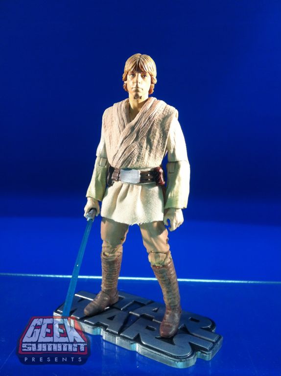

I typically take the easy way through customs and this was an exception but really the things that I did didn't really take so much. There's a bit of Xacto work of course and most of the heads seem to be pretty interchangeable which is nice.
I took an Obi Wan Kenobi and shortened the legs a 1/2", sculpted over the front of the tunic and grafted the texture in with a remnant piece of the original tunic. The neck is from a Han Solo figure.
What I'm proudest of is I used the lower parts of the tunic to graft that texture back into the clay to create the closure of Luke's tunic. That really made the difference. The rest of the work is standard chop shop techniques: paint matching and sculpting.
