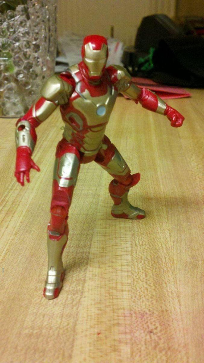

UPDATES! Added Revoltech joints at the knees, but still have bendable wire for the elbow joints. With the Revoltech knees, the figures are now in-scale height wise with the IM2 figure line.

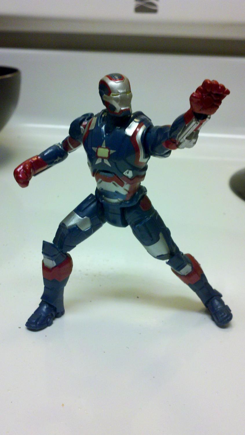

So... realizing that there seems to be no plans for quality 3.75 IM3 figures, I decided to use my "hobbling" bendy wire technique to add some poseability to these p.o.s.'s. Brought the figure to about Avengers movie line articulation level, and it is now a semi-decent 3.75 stand in movie line figure. Iron Patriot now has:
1) bend/swivel elbow joints
2) outward hip movement (gained by tapering the hip area of the upper legs and routing a notch around the hip pegs to turn it into more of a "ball" joint)
3) bend/swivel knee joints
4) bend/swivel repulsor wrist
I'm actually having fun with this fig now, and just have to stick a filler piece on the lower thigh area to fill in the gap there that will sink into the knee guard. It worked well enough and was so easy that I ordered a MK42 Assembler to mod. Total mod time was about 15 minutes.

Not bad, did the leg mods add any height?

No, no additional height added. It ends up being the same exact size it is in box even after the wire joints are in.

I'm actually going to try out revoltech joints for the IM MK42 Assembler, and I'm pretty sure that'll add some length to the arms and legs. I'll post up once that gets done.

Are the shoulders the stock ones?
Also if you could add a bit more details on how it was done that would be great. I would like some IM3 figures, but the way they are from the store is horrible! And they didn't even paint the palm repulsor!

The shoulders are indeed the stock ones... they're actually the ONLY redeeming factor on the Assembler figures. I didn't plan on doing up any of the other IM3 figs except the MK42 and Iron Patriot, but I'll try elaborating more on the process. You'll want to read my other custom WIP thread here first for the basic idea on how to do the elbows:
http://www.toyark.com/hobbling-my-5-...lution-124204/
It basically comes down to cutting the Assemblers at the elbows and knees along the panel lines sculpted into the figures. Originally, I ended up just using bendable aluminum wire for both the knees and elbows, but later installed revoltech joints at the knees to make the gap less pronounced. The elbows have wire joints, but the gap is not bad at all so the revoltech joints aren't necessary there. Getting outward movement at the hips is also really easy; Iron Patriot required a little shaving at the top of his upper legs to allow for a little more movement, but the MK42 is slim enough in that area to allow good range without any mods. The T-Crotch on these is surprisingly non-limiting on the Assemblers, and is close to ball joint level of movement (like older MU figs).
All in all, simple mods, but it does wonders for making these toys way funner than they were designed to be.

6mm would work... you'd just need to dremel out a bigger portion of the lower thigh and knee area to make it fit. I used 4 mm because I felt 6 might bulge out a bit too much, but in a pinch it shouldn't be too big of a deal.

Which MK 42 is that? It looks taller than the single pack one. Is it the one that comes w/ the car?

It's the regular single pack MK42 assembler. It's taller due to the added revoltech joints in the knees.
