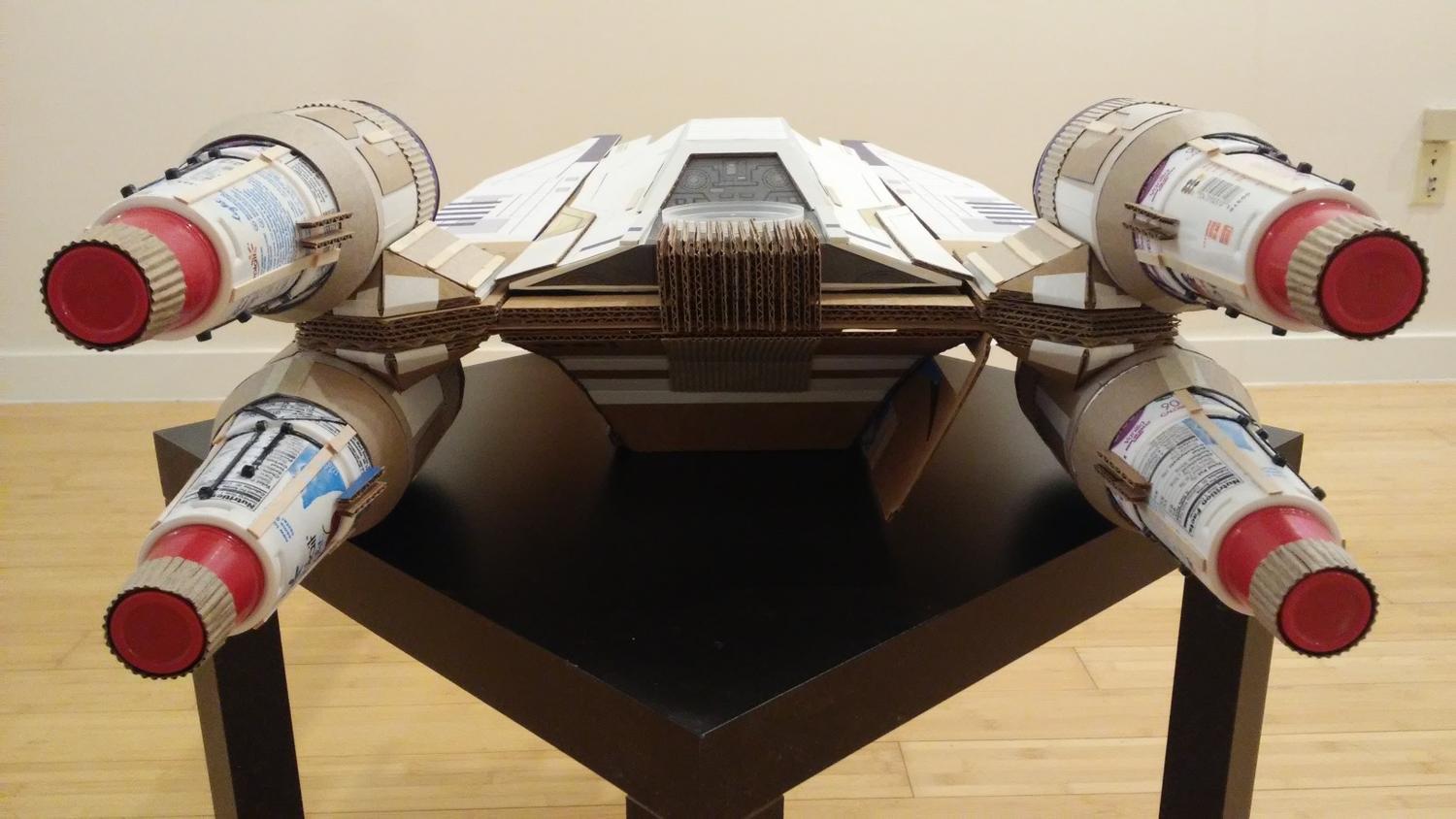

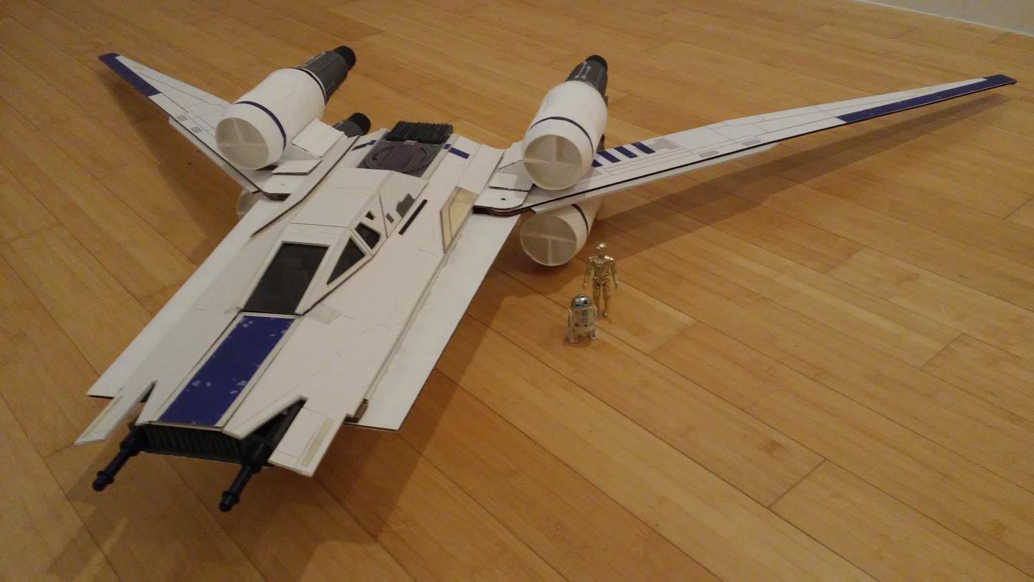

This 1:18 scale U-Wing (from Rogue One and the fourth season of Star Wars: Rebels) is made from cardboard and paperboard. It’s designed for the 3.75” action figures. The building plans I designed are free for all Star Wars fans who want to make one of their own. Links to the plans are at the end of this post.
Length: approx. 55 inches/139.7 cm. Wingspan: approx. 6 feet/183 cm.
Templates
(Building plans and photo guide)
U-wing 1-18 scale templates w UPDATES 1 and 2

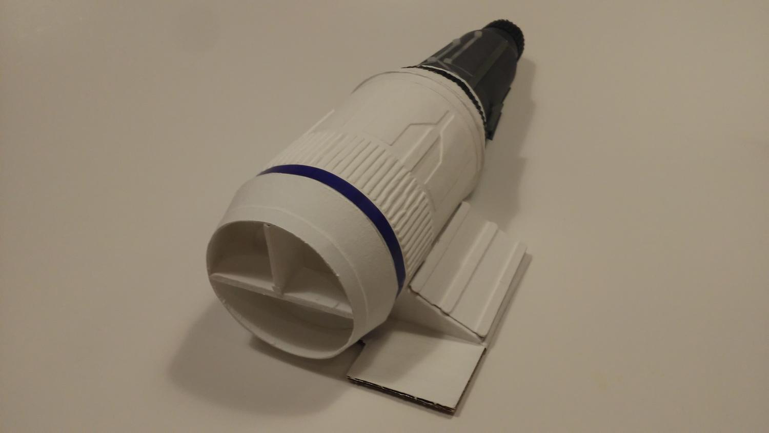

Alternate Engine Build
(Build the mid- and end sections of the engines so you won’t need to paint them)
U-wing 1-18 scale alternate engine midsection and end

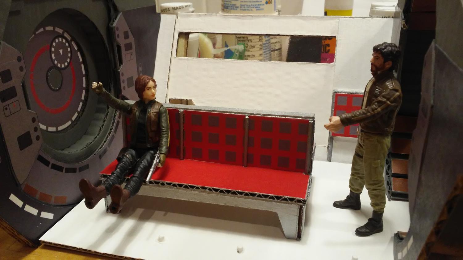

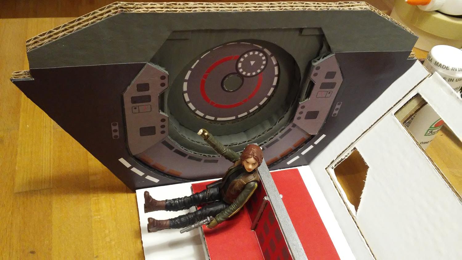

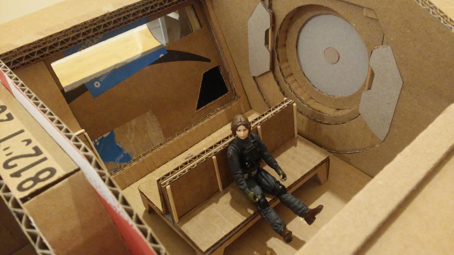

Other news: I may design and release separate plans to finish out the inside of this U-Wing, maybe this summer if I have the time. It would comprise of these main elements:
1. The backplate with the circular power reactor (I envision that we could use the bottom of a large, plastic juice bottle for this).
2. The removable, 6-seater bench.
3. The two archway pieces that separate the cockpit and troop hold sections.
4. And, of course, two separate pilot seats. (The single cockpit seat in my current design has always been meant to be a placeholder.)
If my U-Wing vehicle playset could be considered a dollhouse (which it essentially is), then these four things would be furniture. So that's why I plan to release the plans for these as a separate download kit, and not as an “update” to the main build.

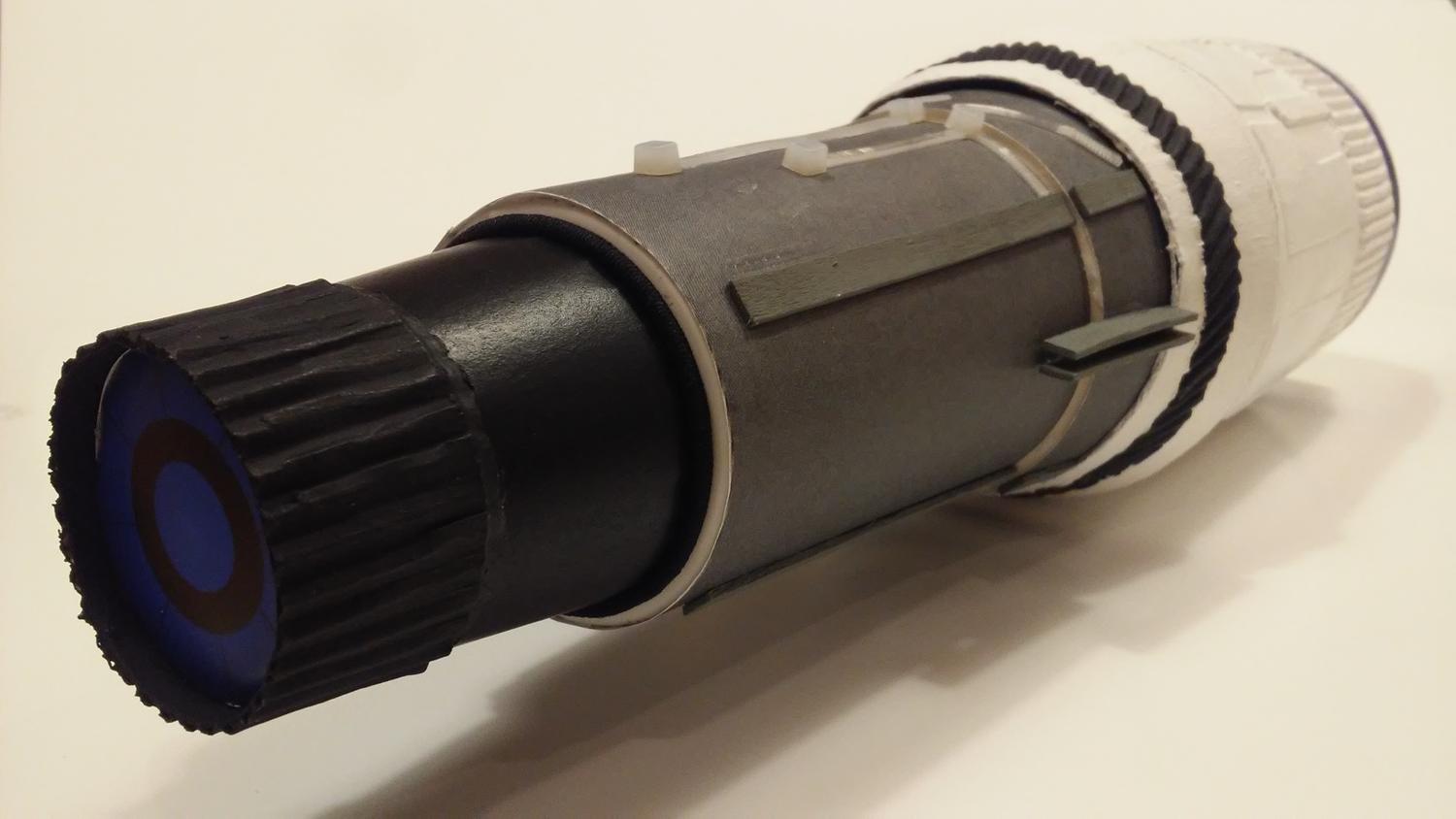

A question I’ve been asked: if you’re not familiar with model building with cardboard, how should you start trying to build this U-Wing?
My recommendation is to start with building the cannon housing. It’s a small component and not too difficult to build, but is also one of the most important since it “anchors” the look and underlying front structure of the ship. Focus on getting it right, and you will be well on your way.
Next, build the top cockpit. Focus on getting this part right. You’ll need to use the xacto blade to carefully cut out the windows, and this should encourage you to hone your cutting skills.
Next, build the top section. It’s just 5 main pieces (without the detailing).
Next, cut out and assemble the wings.
Once you have the above 4 components built correctly, this should motivate you to continue because when you arrange these parts on a table or the floor, you will see that it’s already looking like the U-Wing. You’ll have the top section of the ship, which should give you a boost and sense of accomplishment.
The troop hold can be difficult to put together and align correctly. I suggest building it upside-down. Temporarily tape the sides of the troop hold to the bottom plate/floor of the troop hold, then tape the sides onto the large core plate. Take the three sections of the back: temporarily tape the largest bottom piece (which would be the top piece, right-side-up) to the troop hold sides, and adjust to make sure the sides and bottom are properly aligned. Then take the smallest, top piece (which would be the bottom piece, right-side-up), and temporarily tape it to the troop hold sides, adjusting to maintain proper alignment. You fit in the middle piece last.
It is important, of course, to ensure that the troop hold’s sides and bottom are in correct alignment. Otherwise, the ship’s bottom section will be lopsided, and this will also throw off the three triangle pieces that make the lower cockpit windows, the moulding pieces that join the troop hold and lower cockpit windows, and mess up the sliding of the doors.

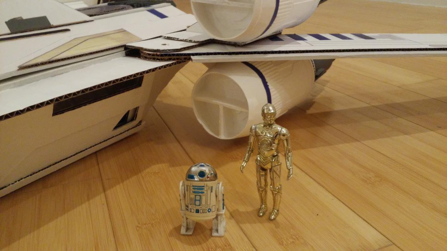

A good question I’ve been asked is what tools did I use to make this U-Wing. And here they are -- not pictured are super glue and toilet paper.
Just as I wanted to keep the materials that the U-Wing is made of simple, cheap, and easily acquired (shipping boxes, food packages, etc.), this philosophy extended to the tools. There is nothing expensive, hard to find, or “exotic” about these tools.
The Sharpie marker was used to trace the template patterns onto cardboard sheets. The red pen was used to mark measurements.
Masking tape was mainly used to temporarily hold pieces together until they were glued. The tape would be carefully pulled off before pieces were glued together.
As for the glue, believe it or not, it’s just cheap school glue. I suppose a hot glue gun could be used, but I avoided using this, because hot glue tends to dry too quick for me to handle cardboard pieces, positioning them correctly before the glue dries. School glue is designed for paper, and that’s what cardboard is -- two thick paper sheets that sandwich a corrugated (fluted) sheet between them.
The coffee stirrer was used to spread the glue thinly across the cardboard, wipe off excess glue, or jab glue into tight spots. Toilet paper was used to wipe away excessive amounts of glue and also spread it.
The only other kind of glue I used was super glue. You should use this when gluing together the plastic cups that make up the engines, and when gluing plastic detailing pieces onto these cups. Don’t use super glue on the cardboard or paperboard. Super glue doesn’t work as well on paper and damages this material.
The glue stick is for applying the decal sheets onto the cardboard.
The white masking tape was used on various parts of the U-Wing to cover the ends of the cardboard and other detailing. I didn’t cover all exposed ends. This is mainly an aesthetic choice. (You can find white masking tape in the arts & crafts section of Walmart.)
The black electrical tape was used for the cannon guns.
A cutting tip: Cut your cardboard against two large-sized sheets of scrap cardboard. Even if you are working on a cutting board table that has a surface that can withstand cuts, you will get cleaner, straighter cuts if you cut against two layers of cardboard. This also helps to keep the blade of the utility knife sharp, since it won’t get worn out faster running against the harder surface of the tabletop.

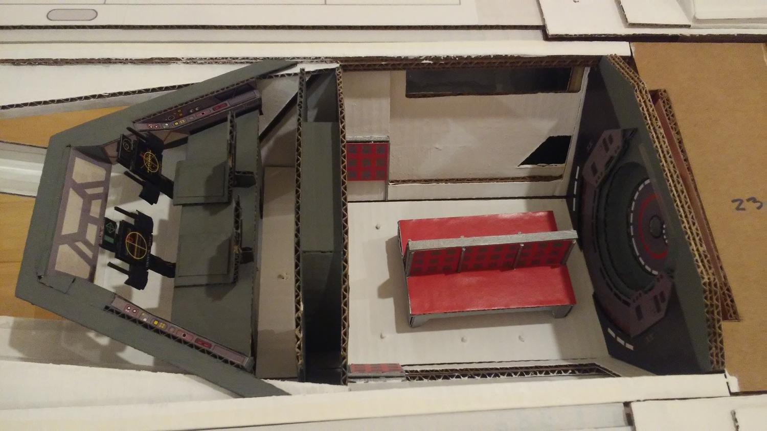

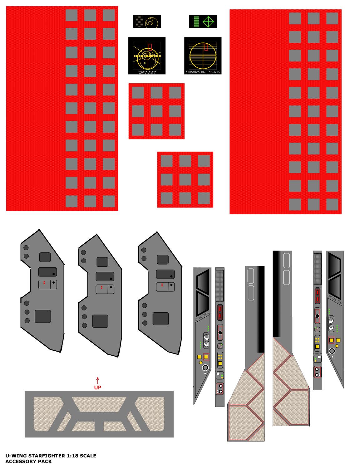

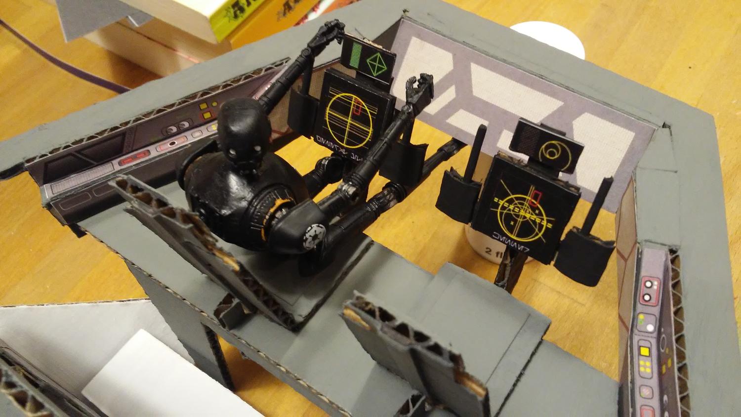

I’m proud to announce the release of the Accessory Pack today!
This ZIP package contains plans and photo guides for building things that go inside the 1:18 Scale U-Wing, turning it into a true playset for the 3.75” figures. This includes the pilot seats, troop bench, and other interior elements of the U-Wing as you see in the movie.
Download it now:
U-wing 1-18 scale accessory pack
The Accessory Pack also includes templates for pieces that improve the look and function of the side doors...
BONUS: you'll find plans in the pack for a rotating gun turret that can be used with the missile launchers that come with many of the Rogue One action figures...
And this Accessory Pack even includes these decals below. (I designed them in old-school Kenner style.) After you've built and painted these interior components, just print these two sheets​ in color on 8.5 x 11", cut the decals out, and stick them on with glue stick or spray-on glue. (Two of these decals have an Easter Egg -- can you spot it?)

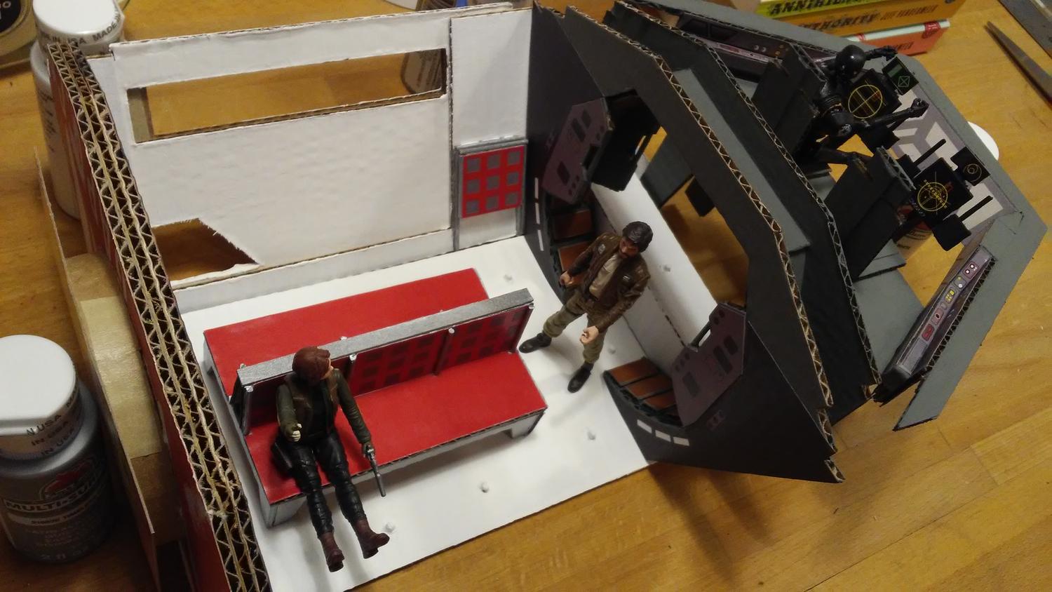

TIP FOR DIORAMA BUILDERS: the components in this Accessory Pack can be used as a display set for your figures.
To build a diorama that is more true to the internal set of the U-Wing as you see in the movie*:
1) Don’t add the front-most piece to the power reactor wall. (This is the sheet of cardboard that has the two handles made with toothpicks). Build another archway (like the one that’s placed behind the cockpit). Put this second archway up against the front of the power reactor wall.
2) The depth of the circle of the power reactor wall measures 0.5 cm. Increase this depth to 1.0 cm.
3) Extend the length of each interior wall mod plate, so that there’s more wall space to fit an additional wall chair (the non-functional square piece) toward the back of the ship. So on each wall mod plate, there will then be two wall chairs, framing both sides of the side doorway.
4) Using the templates from the 1:18 scale U-Wing build-it-yourself kit, assemble the lower half of the troop hold, the bottom cockpit, and side doors. (Remove the starboard or port side of these three pieces if you want to display only one side of the interior set.)
(* -- The interior set of the U-Wing is physically longer than what can realistically fit inside the ship, based on its exterior design, as you see in the movie. I’ll explain this discrepancy, which happens all the time in movies/TV series, between the outside and inside of he U-Wing’s design, and the compromises I made for this, in a follow-up post later this week.)

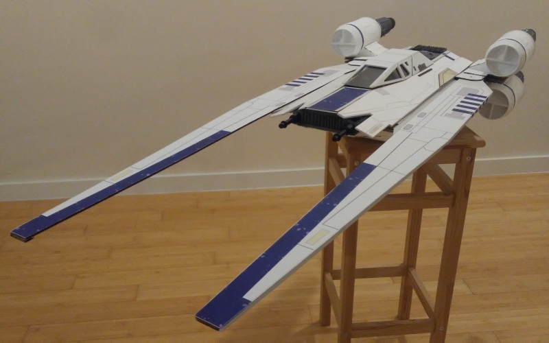

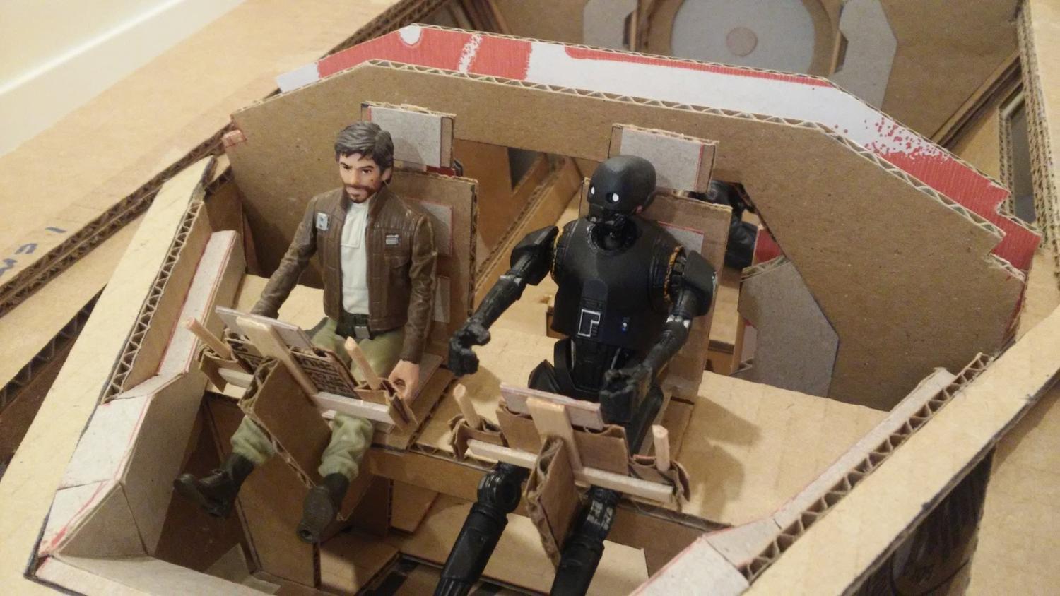

I've been painting the entire playset inside and out. Here is a quickly snapped sneak preview of the interior components fully painted and with the decals glued onto them.
After the painting is done, I'll put online a whole bunch of new photos of the completed ship. I'm also hoping to get a Bodhi figure for the shoot -- you can't break up the team!
At the same time, I'll also post a brief guide that will explain how to properly prep and paint cardboard/paperboard models.

Painting the plastic sections of the engines:
1. Apply BLACK GESSO to the engine mid-sections and end sections (which are made of plastic cups). The black will help cover up the graphics and text printed on the yogurt cups.
2. After the gesso has dried, paint the mid- and end sections with MULTI-SURFACE acrylic paint. (Regular acrylic paint will more easily flake off from the plastic after it has dried.)
3. Alternately: spray-paint the engines, if you are skilled at using spray paint. (You need to use a good quality spray paint that can bond to plastic.)
I suggest detaching the mid-section and end section from the main engine, so that you can spray-paint these sections separately. To do this (if you have already put these components together), carefully cut the rear rim of the main engine and unwrap it. Then you can pull the mid-section and end section off:
My personal paint color guide for the 1:18 scale cardboard U-Wing:
1. Apply BLACK GESSO to the arch, cannon housing, outer-facing sides of the interior wall mod plates, pilot seats (including stand and control panel), power reactor wall plate, rear heat fins piece, engine mid-section and engine end sections.
Apply WHITE GESSO to the remaining pieces/sections.
2. Paint with MATTE GRAY ACRYLIC: arch, cannon housing, pilot seats (including stand and control panel), power reactor wall plate, rear heat fins piece, engine mid-section:
3. Paint with MATTE BLACK ACRYLIC: the flight controls (and the stems they are attached to), and end sections of the engines:
4. Paint MATTE WHITE ACRYLIC: everything else.
5. For the top section of the U-Wing, use a white-out correction pen or white paint marker to fill in the gaps between the plating sections:
6. Paint in SILVER ACRYLIC: the troop bench:
7. DO NOT paint the underside of the wings. This will add weight to them, and probably cause them to bend. Leave them alone, since people will rarely see their undersides. If you still really want to cover the original cardboard, cut to fit and glue white paper sheets, or white construction paper, onto the undersides of the wings.

U-wing 1:18 scale engine alternate build
It can be difficult to properly paint the plastic sections of the engine -- the paint might peel or flake off due to the flexible nature of the plastic cups. So here's an alternate way to add color to them, by glue-sticking paper wraps around these cups.
You can download the photo guide to this engine alternate build as a PDF. Or, scroll through the step-by-step photos at the second link below. (These photos also show a closer look at the layout pattern of the engine detailing that uses plastic wire ties.)
U-wing 1:18 scale engine alternate build guide (PDF file):
You can view the complete photo guide to this U-Wing engine alternate build here:
