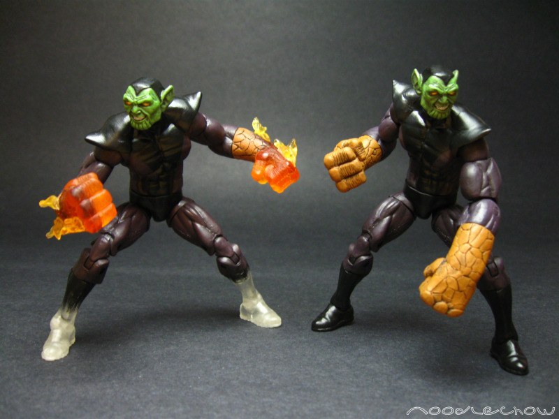

Hey guys, I'd finished both Super Skrulls and finally got a decent dark backdrop to shoot em against. Figured I'd try my hand at sculpting parts while learning how to cast so I'd say this project was worked on over the course of about 4-5 months which was mostly me futzing around with materials and going back to the drawing board a couple times. I hope you guys enjoy the finished product.
Questions, feedback and critiques are much appreciated. Recipe is at the bottom.
Body - Cable torso and legs.
Head - sculpted using Super Sculpey Firm then molded and cast.
Arms - Fists sculpted from scratch with Super Sculpey Firm with Apoxe Sculpt touch ups. Biceps and Elbows were modded Cable arms merged with XMO movie Wolverine's hips then sculpted over with Apoxie Sculpt. also molded and cast.
Lower Legs (invisible) - clear resin casts of original legs.
Shoulder Flair - Apoxie Sculpt
Paint - Testors Acrylics
Flames - resin casts of chopped up flame bits from a Toybiz movie Human Torch figure.
