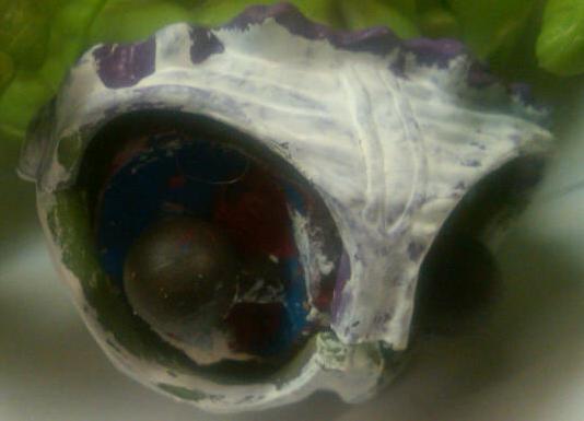

Torso Surgery...
I popped apart the lower torso on Hulk and removed the legs from it. Then i drimmeld out the cavity so that it was hollow except for the area that holds the lower torso to the upper torso. In this cavity I inserted the hips (only the hips) from a broken MLS Juggs and glued it in place (this took some sanding on all parts involved. Thi allowed for the leg/hip balls from the MLS to sit up inside the MU hip socket. Once all of these pieces were fitted, I went back over it with some glue and sealed it back up to dry over night.

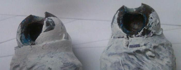

Leg Surgery...
The legs were a bit easier to fix than the torso. I took an exacto blade and ran it inside the leg along the ring post that attaches the leg to the torso (severing the post holding it in place) on both sides until the ring could be removed. Then I cut out the inside of the thigh along the area that previously held the ring in place. Once this area is removed, i took my drimmel and created a cavity inside the leg (using sanding and griding bits to enlarge the cavity). I enlarged the cavity inside the leg to the point that it would hold the ball joint from the MLS Juggs (plastic was warm so was able to push in an make indentures where needed) then i drilled a hole in the leg to allow for the MLS leg peg (too lazy to cut off... in case it did not work). Once the MLS piece was fitted inside the MU leg i glued it in place and again glued them and let them sit over night.
MU Hulk Fix-hulk-surgery.jpg MU Hulk Fix-hulk-surgery2.jpg MU Hulk Fix-hulk-surgery3.jpg MU Hulk Fix-hulk-size.jpg
